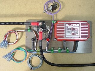

John at JSS does clean job on his wire organization
SuperJETT
none
Drill holes under the components, run the wires to the back so they are hidden, then route the wires over to the right side of the engine compartment and up to where they need to be.
Make sure you lap the flywheel to your crank and 5200 the wires coming out of the trigger to prevent problems down the road.

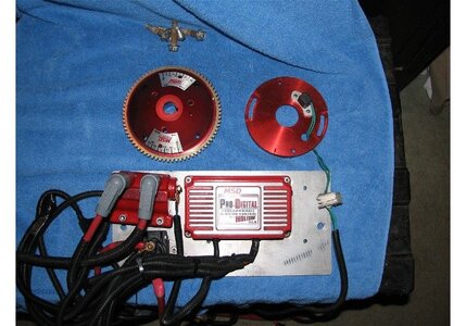

Here was mine:

Cool, I can set mine up like yours, all I have to do is flip the plate so the coil and relay are on the right.
douglee25
m3booooy
South Jersey
A good idea is to use grommets if you're gonna put wires through like the above picture. The constant chafing could cause some problems down the line.

Yeah, if I go that route the wires will be shrink wrapped and rubber gromets will be installed.
