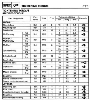

Motor moubnt torque specs
Ericfox
Do it twice?That's DooDoo
um... pretty sure its only 12 ft lbs for the single bolt... but I used 14 with blue loctite... maybe my motor will fall out.... hopefully not! I was told blue is fine for those bolts by a reputable engine builder... the 12 ft lbs is what I recall from the shop manuals I have looked over...
