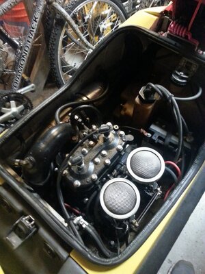

Dual carb on what look like a bone stock engine can be a little to much. If its the "round body" mikuni you don't have to many options, in the "square body" mikuni you can change the jets with more options. Round or square body carbs? Look on the side of the carbs, you either has a round housing with 6 screws or a square housing with 4 screws. Been there and done that, "round body" carbs look good on the book shelf. As kevbo said, get the newer stock carb or mikuni SBN 44.
