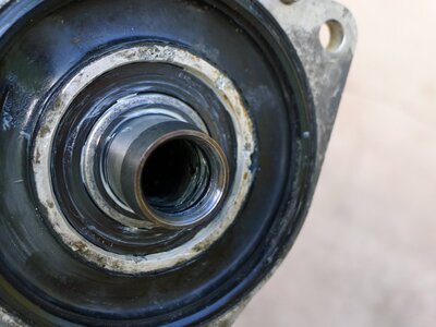

Here is another important reason to remove the midshaft assembly while the engine is out: the 2 o rings inside the shaft should be replaced occasionally. They wear, then water enters the spline area, the grease washes out, then the splines of the drive shaft as well as the midshaft wear out- that gets expensive. The m/s housing bearing is a commonly available 6205- sealed- not expensive. The picture shows the location of the o rings inside the shaft.P1020896.JPG
