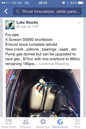

So I brought this x scream 900ss off of luke stocks after being told it had a brand new OEM crank new bearings pistons seals and a new boyesen manifold the motor tuned up with half a manifold (no plate) with no fittings or gaskets.

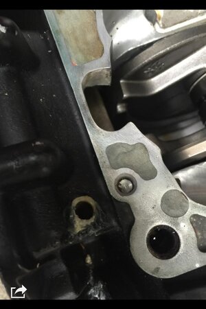

One of the pulse spigots is missing completely because it looks like it was stuck in with toothpaste.

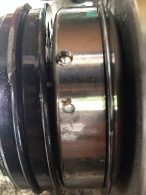

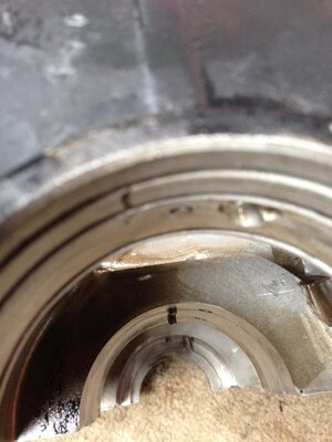

I have stripped the engine to send the crank back to him who ever has built the engine has not lined up the bearings on the crank to the pins and they have proceeded to build the engine this was supposedly built 8 hours ago
They have crushed the pin in to the cases but it's not flat the bearing is sat off a little so it would have caused massive wear on on all the internals of the engine there is water sat in the grove where the out side seal sits so the cases must not have joined together properly coz of this

He reckons I have coursed all this damage but I have never even started the motor so how could I the crank has a nice amount of rust on it where the damage is
