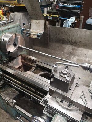

Machined driveshaft to correct length, 638mm. Got 2mm of when tig welded. But whit a press and good measuring tools it's now straight.
Also the middle shaft is shortened to 148mm,
