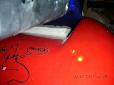

it only rubs at the front on the sides...it narrows as it gets to the bottom and only allows the pole to go down so far
i put some ht layerd up so it would only go down so far and wouldnt crack anything
and yes this is with the wammer hood...i think a few others do it as welll im not sure

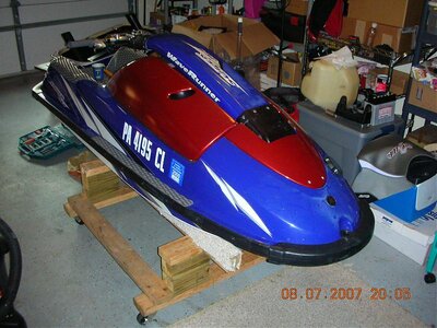

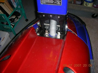

you are safe either way...it will work look at my pics...x metal bracker wammer hood stock pole it worked for months
nothing to worry about
one of my pics is of it up
and two of it down
if u want a new pole get one ...i think it looks wayy better but you may run the stock pole and hood and after market bracket together
