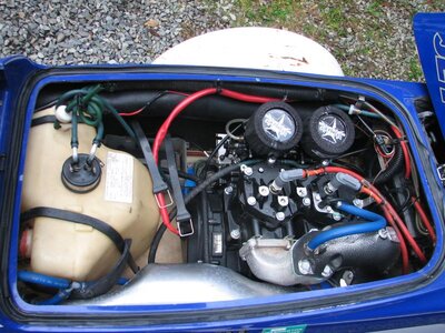

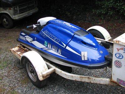

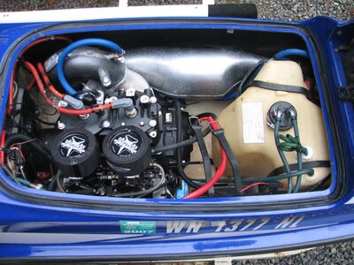

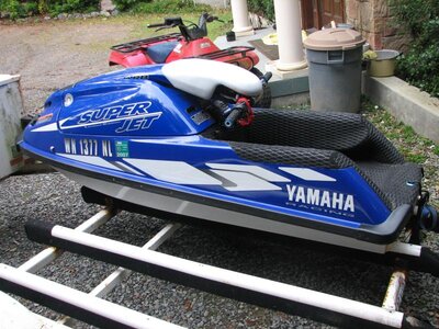

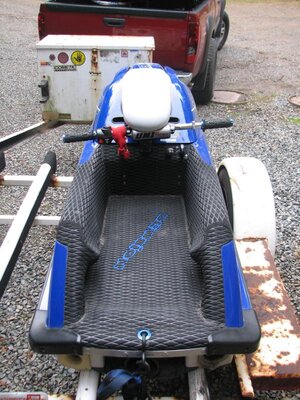

Looky what I just picked up today....

Oh Yeah that is a nice boat huh? The pic's we had you couldn't even see the blowsion logo in the matt.
hell maybe I oughta just keep it for myself lol

You should, that sombitch is sweeeet. Note the UMI steering and Blowsion turn plate, one way, ODI grips, and a Hooker prop I believe.

Ive been looking at that thing on CL for like 2 weeks now. So it's a '99? What pump work was done? Looks super clean. Colin must be stoked!

All I know is he had the new prop put in about the time the Hookers came out, made a big difference. Stock pump, freestyle cone. Jayrad trained it to roll on flat water too.

-factory b pipe (do the research, the best you can get)
-kenny keepers (stops the motor from pulling out of the mounts when upside down)
-msd ignition (great mod, more spark and adjustable rev limit)
-solas prop with 13mm cutback for bottom end grunt
-blowsion turn plate for fully adjustable turning
-umi 0 degree bars w/crossbar
-blowsion flame arrestors w/water socks
-Carbon fiber reinforced hull
-blowsion one way valve (clears hull water VERY fast)
-Rule 500 bilge pump w/switch
-Blowsion mats
-Blowsion custom footwells (a must have)
