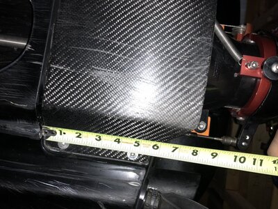

Looking for an extended ride plate for my C1 Hurricane ski
I have been searching all over the web, but have not found any ride plate options for my ski. I have attached a photo to show how many inches apart the screws are. Does anyone have any recommendations?

I let somebody ride my green C? and they blew the plate off by ass landing it. hurricane sent me a new plate but its the wrong one. I dug thru all my plates to see if any would work. jet dynamics superjet and the Polaris octane stock plate will work if the sides are narrowed a bit on each side to fit in the groove and new holes are drilled and its cut off in the front and reshaped to fit and the back end cut to the length you want. I haven't done it yet cause they are supposed to be sending the correct plate and I have other skis to ride. by the looks of your pic , that's the plate I need.
I may try modifying the jet dynamics superjet ride plate to fit. Would either ride plate work (Superjet 1990-2007, Superjet 2008 and up). And is it the extended plate from Jet Dynamics you are referring to, correct?
