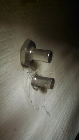

put a little 4200 silicone on the bottom flange of the pisser, put it through the hull (have someone hold in place and @ what angle you want ) slide the coolant hose on really tight to the side of the ski and clamp it down with a hose clamp. then ziptie the coolat lines together let it set for a day and youll be good to go. done it before in a pinch for the same reason and ran it like that for over 3 years
