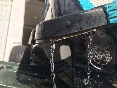

I posted this before but i believe in the wrong Thread. My 2015 Sj leaks pretty good in the rear corner of the ski. So I've had it sitting vertically nose up and down since august until i couldn't get anymore water to drip out. After digging around the forum for a while i think i came up with a plan. Somewhere, someone had a similar issue and drilled in zerk fittings around the damaged area. Then used a sacrificial grease gun to inject some six10 epoxy. I was hoping to get some more input before i start, what do you guys think?
Hey - if you use a WestMarine kit the come with a syringe and the right consistency of epoxy. Put the boat upside down and then syringe it in and then it needs to be clamped - the epoxy has to bond the surfaces together - use a bunch of small clamps from Harbor freight.
