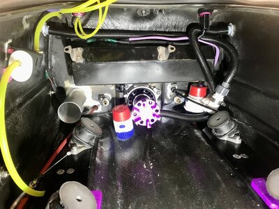

These are my e-box mounts to give you a reference... Those were drilled out by the PO and I have since installed normal SJ mounts with the studs attached. Works much better than trying to hold the nut on the backside of those old ones haha
