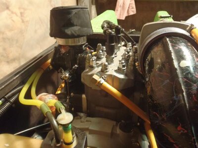

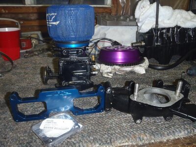

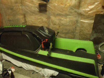

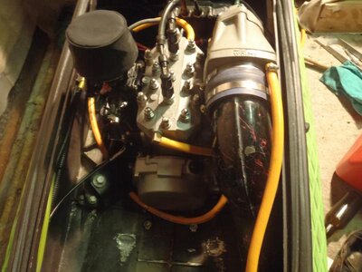

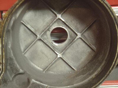

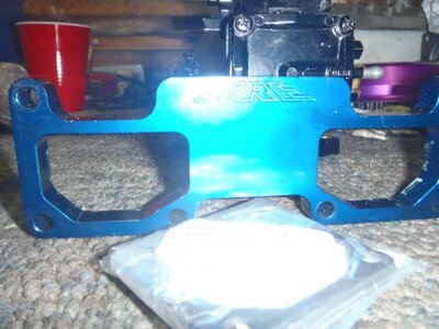

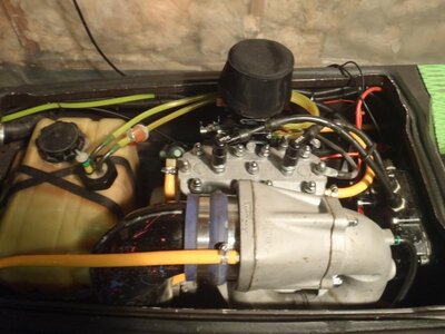

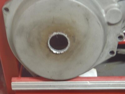

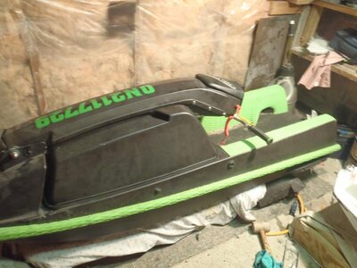

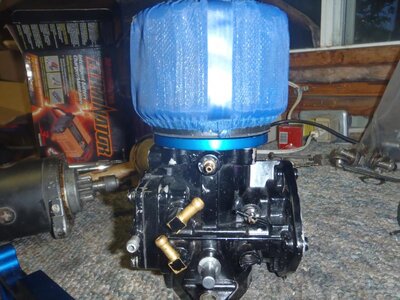

Just wanted to share some pics of my 550. I just finished a budget rebuild on the motor after melting a piston at the end of last season. I didnt want to sink alot of cash into it so i found some pistons on fleabay for 20 bucks each with rings. i had an extra cylinder with a decent bore at 1.5 mil over. i honed it out, and sandblasted everything. i bored out the cases and put everything back together and fired her up. nice.
