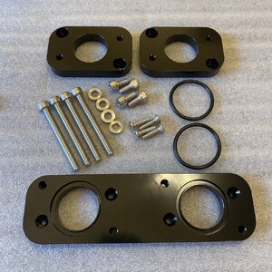

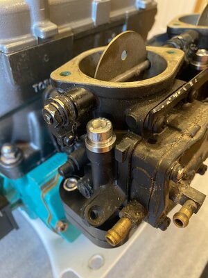

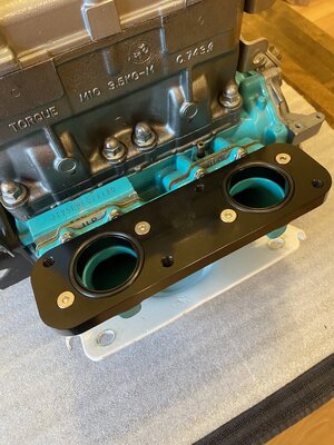

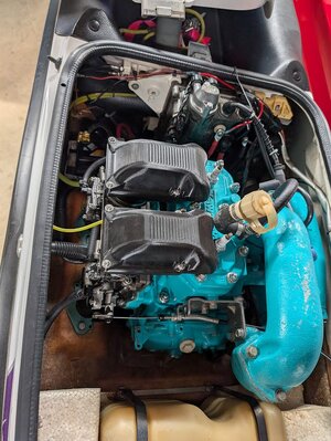

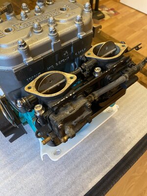

Do you have set of Kawasaki SXR 800 Mikuni SBN i40 carburetors you’re wanting to install but can’t find the rare SXR 800 intake manifold to mount them? We have the solution!
Our new 3-piece Kawasaki i40 intake manifold adapter allows you to mount your OEM SXR 800 SBN i40 carburetors onto a widely available Kawasaki 750 intake manifold!
No more waiting months to find an overpriced SXR 800 intake manifold to put on your 750 engine or replace your missing/damaged OEM SXR 800 intake manifold.
Billet 6061 T6 aluminum 3-piece intake manifold kit comes with everything needed to mount your carbs and go. Includes all stainless steel mounting hardware, o-rings, custom spacers, and carburetor mounting bolts. Aluminum components anodized black for corrosion protection.
$90/ea + S/H
