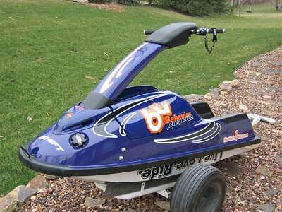

2000 Superjet

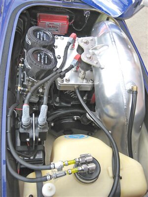

Motor
Stock 62T cases
Tim Judge (Riva) ported 61x cylinder
Riva head (35cc domes)
MT V-force reeds w/spacer
dual 40mm Kawi I-body carbs (custom quick change intake adapter)
MSD dual channel digital TL
Riva freeride dry pipe/Riva manifold
Pump
140mm 12vein skat
C75 14/20 swirl prop
Skat drive shaft
Sato Nozzle
R&D pump shoe

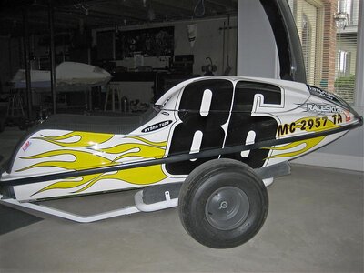

Hull
Shortened stock pole (-1.5mm)
Standard UMI turnplate
UMI bars
ODI rogue grips
PJS throttle
Tiny Tach
Riva rear sponsons
Wammer CF ride plate
Worx 205 grate
And just about every little goody JSS sells since this was John's old ski.

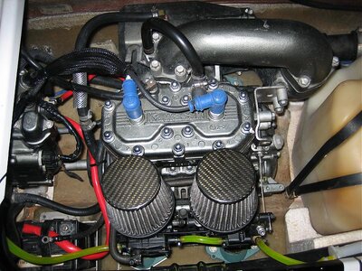

Stock SXR except for a CF pole, R&D plate/grate, and a prop I am sworn to secrecy about. Actually "perfectly stock" is a better description for the ski. This is Rob Flores' old ski, the one he won the worlds on (stock class).

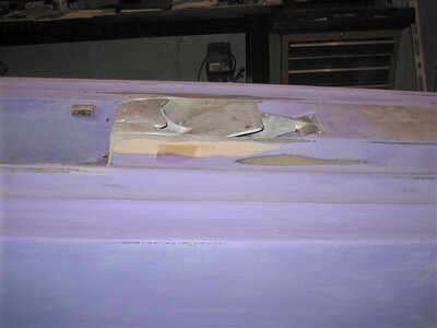

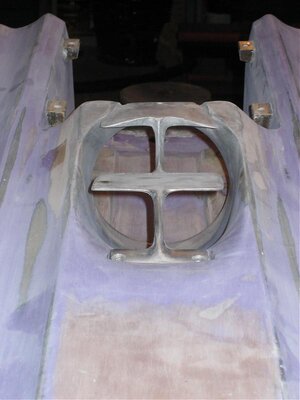

1995 FX1

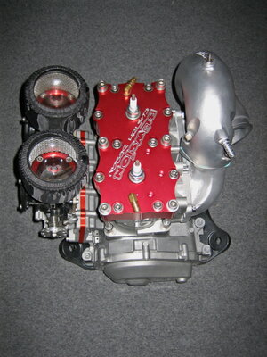

Motor
Just Joe filled and ported 62T cases (Jett style)
Z-force ported 61X cylinder
Pro-X pistons
OEM crank
Blowsion head w/35cc domes
Dual matched 44's
FP FX1 chamber
MSD Enhancer
Lightened flywheel
61X stator

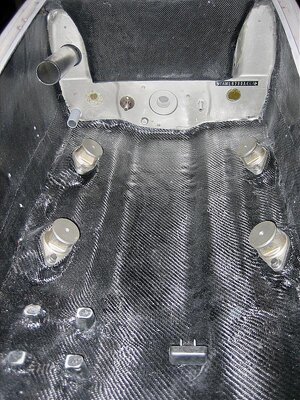

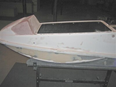

Hull
***under construction***
Trued hull
2 layer 17oz biax reinforced gunwales
Fresh 4lb foam
3 CF layers in hull
Blowsion Tubbie II's
Dawson diggers
CF wrapped handlepole
JD ride plate
JD grate
Pump
144mm pump
144mm JD shoe
cutback 13/16 Swirl prop
Blowsion cone
Rest is TBD...
