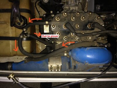

Posting over here because I didn't get any feedback on pwctoday. Getting ready to head out to the Bay on Saturday for the first time on this ski.
Are the cooling water lines on this exhaust hooked up properly? I noticed in the photos of any other ski I could find, the tee to pisser is in the line between the pipe and stinger. And not in the line between the head and pipe like this ski.
Is this a problem? Or just going to run the exhaust drier? Or overheat the exhaust?
Thanks!
