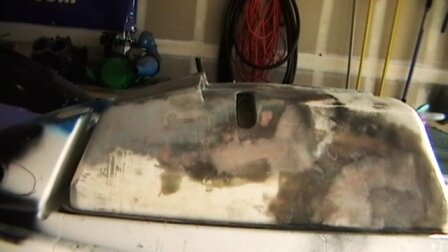

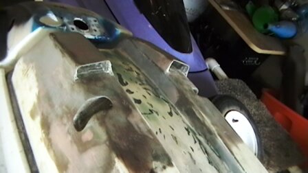

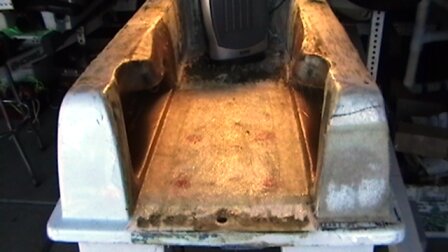

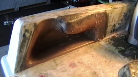

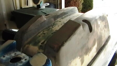

Well besides other projects ( pics and other will follow ) I had a 550 fun-project which I attended during slow-time and especially while waiting for other SJ parts. The projects goals >> to keep the budget very very low and learn to Fiberglass and also create a one of a kind ski....
This is my first experience with Epoxy-Resin-Fiberglass work so bare wit my abilities ( I am an engine mechanic ).
The hood has custom air intake scoops built strong/wide enough to be handholds at the same time + additional custom Handholds.( louie you should make a mold :0).
Also installed Waterdawg footholds which fit perfectly.
Further plans are to create a dual front exhaust therefor will have to weld a T-pipe.
Engine has not finalized yet ...we will be surprised...I hope :0).
I will keep the pics coming as I go but update times will be slow due to other projects in the make..
Thank you
Chris
