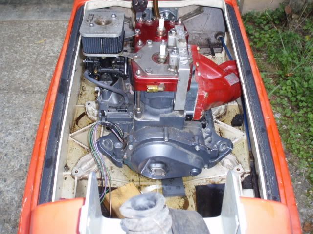

js 440 weak points
is it unreliable or just under powerd? I will be swaping a 750 into it next summer I just want to know if the hull is crap because then I will be looking for a different one. I saw that the 550's have a weak spot in the side of the hull that likes to crack if you land hard on the side, is that the same on the 440's?

yeah just get it running, not enough power there to really mod and get anything out of it...not worth the money either. Check the thru-hull driveshaft houseing, make sure it packed full of grease and grease the pump also, on the back of the pump there should be a grease fitting(cant remember if its covered by a cone or not, its been too long) and make sure that has grease in it too. Everyones right they are prone to cracking and stuff but its a great cheap learning ski! thats what i learned on.
you could do this
when/if you end up swapping a 750 motor you will need to upgrade your pump. I believe the unit from a 750 bolts in with little to no pain involved.
For the money you will sink into it you will be better off finding a square nose for under $1000. I would ride what you have and when its not enough anymore sell it. Too bad you are in canada, i have an sx300 for sale that would be a great candidate for a motor swap
