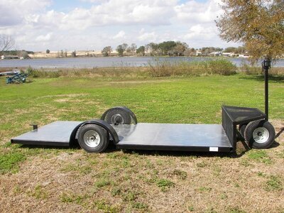

because where i mainly ride and have property your standard size vehicle trailers dont fit in the trails, that jetlift trailer is really nice, although im in canada, after the exchange and high shipping thats over 3000$ for a trailer that small, hence why i need to custom build one

That makes sense. How much width can you handle on your trails?
Single place jetski trailers are only something like 42" wide and would stand up much better than a modded beach cart, plus they usually have winches to aid with retrieval.
They can be picked up around here for a couple hundred bucks but such things are much more common around here.
I’m in Alaska and have 5 jetlift carts.. time is money too. You won’t build the same quality that jetlift is making now for cheaper. I had a design all worked out, then priced it out. Way more unless you build 100 of them. The wheels are the biggest shipping cost. The jetlift carts come disassembled for shipping. You can buy the wheels from Amazon if you are really cheap.
Only thing I dont like about the carts is the tires make it float. Can be a pain to load.
Otherwise consider a hitch hauler for pickup. Best bang for the buck. Fastest in out of water.
I built this trailer a few yrs ago to haul my 550 a few blocks behind a hopped up golf cart. It worked great, even at 25 or 30 mph.
It's made of a galvanized fence post, some angle iron, 1 PC of DOM, an eBay axle kit, a pair of old ATV rims and tires, and a pressure treated 2x6. Cost me maybe $100.
I have since sold the golf cart & am using a Jeep Wrangler & a hitch hauler. I'm thinking about picking up a Gorilla cart from North40 to modify for hauling the ski from the Jeep down a trail to the river bank.
