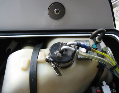

I know many people have made the internal fuel for superjets and sxr's. How about that small FX1 tank? Haven't seen anything about that yet. If anyone has done it, please let me know what/how you did it.

look through the fx-1 section a little better there are 2 threads i think about it. superjet tanks with internal and fx-1 tank with internal
Flash-FX
No Square..No Round..FX-1

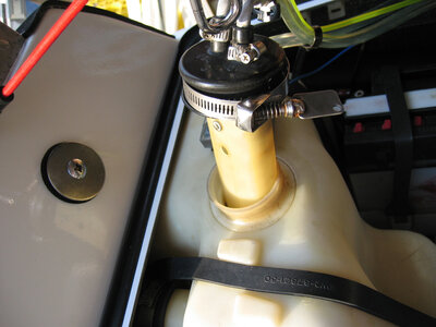

Here's a quick way to convert your tank. Weld a washer or tab onto a quick release SS clamp, sand down the filler neck a little, then cap off the old inlet filler neck with a Fernco rubber cap. Don't get too carried away. Some guys never look under the hood...

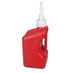

Get a new fill tank that's legal like in the picture. Cheap like 29 bux from Summit Racing... No spillage. :biggthumpup:
Looks great! Thanks very much!
