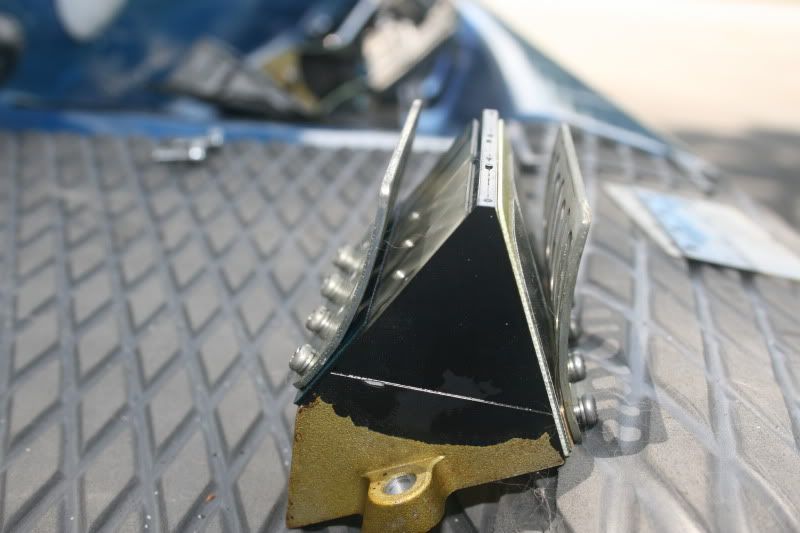

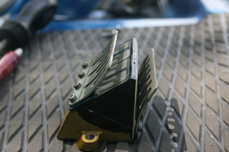

they were the right ones... heres a pic of the old (left) and the new (right)
one of the 4 screw holding the reed stoppers on was stripped so 3 is going to have to do.
notice how much the dual stages raise the reed stoppers, plus the rev plate.
i noticed the old reeds were not stock, should i still have to tune for these? if so any pointers?

i don't think reeds make enough of a difference that you will need to tune. i would just run it and if you feel the need to turn a screw in or out 1/4 turn then go ahead.
