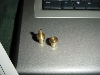

You should have a brass insert with a nipple, and a brass insert that is a plug. After you get the choke shaft out, you will need to press those in the holes that the choke shaft was in. If you leave it on the ski, I would recommend you stuff the carb throat with a paper towel or two before you even start.

i think you are probably missing a few pieces. you should have 2 brass plugs one solid and one has a 1/8 barbed nipple. thats where the fuel line will go. you will also need a 1/4 to 1/8 barbed tee for the fuel line.

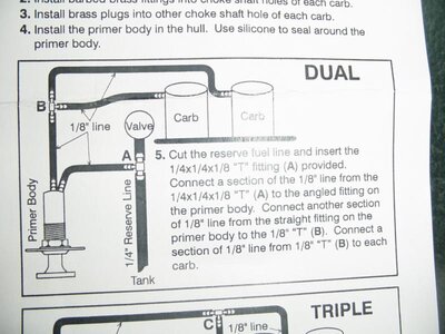

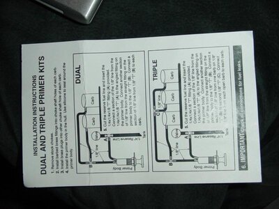

hows this.....
the diagram is for duals, but it should help you see it.

beautiful x2, and the last pic, the nipple is on the left(the thing that shoots the gas into the carb) and the block is on teh right (that blocks off the choke i remove)
correct?
and i would LOVE to take the carb inserts :)

i think you got it! those in the pics are what i have pm me your addy and i will try to get them out before i leave town.
