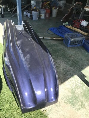

Any input on X2 Hull mods? So I got an X2 and I am hooked on them like crack now…typical right? Anyway, I have two hulls going right now and I am a little ways away from finishing either so any valid opinions that would help Me build a better ski are appreciated. I am in San Diego so it’s either mission bay that’s jammed up with boneheads or SD bay for some big wake action. The first hull I shaped with the intention of trying to float and 1100 but now I’m looking for a FPP 750 limited or SXR 800 pipe. So the second hole has a front fill and I’m leaving the bumper to block spray and cuz it’ll probably be the daily this summer…. my projects tend to get out of hand quickly. Right now plans for are a for a 2.25” stainless glass pack hollowed out in the right floorboard so the weight is farther back and on the right side to counter that heavy 1100 pipe on the left. But right now I’m thinking that a 2 inch TDR water box would be a better deal if I can find an 800 limited pipe…

So, that ski was my baby…sp 750, SBN44, FPP limited(with mani and headpipe)with the bubble mod, drilled water box, timing advance, worx 202 and pump stuffer, impros hooker 9/15, chopped 2”, stock ride plate, extended nozzle,
I want that ski back…I haven't ridden many others but mine hooked up, hit, boned out at 50+ everyone that rode mine thought it was quick. Stock compression but run a little octane booster cuz the 6* timing advance-I never had a problem with getting hot or pinging…only BRAAAPP! Two lower screws on the head pipe were frozen when I got the pipe. I adjusted the top screw until chamber sizzles after I go hard for a couple min. I’ve gone the last couple winters when the water is in the low 60s…my ski loves it, hits hard for the whole tank. I haven’t had problems with water ingestion since I put an aluminum shield on the bottom of the hood between the intake duct in the hood and my carb to direct any water away from my fa. Before that it was a regular occurrence
I’ve already pretty much got this hull worked out and just need to glass it but am still second guessing the rear exhaust. The thing is the weight- it will be lighter than my stock waterbox by like 2# but it will be in the tray and be able to fill with water. Originally I intended to mod an 1100 pipe with center bleed and run this 2.25” stainless. Now the 2”
Aluminum TDR waterbox seems like the ticket as far as water ingestion. And I kinda like my side exhaust. I can keep it in the water and be quiet if I want…

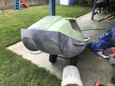

Shortened the rear but I left the ride plate cuz I feel like I get on plane faster and think it helps with the hops. I weigh 150# so that definitely helps…got the squirrel cage and umi steering going on this build as for the tubbies…I thought about making some when I did the front fill but I think I might be better off buying some tubby 1 destroyers. Front fill is done now. Finally

You're putting wayyyy more work than I would into a x2 haha but the front fill looks great! I'd consider that level of modification if I was going to build a race ski but mine is just a rec ski.

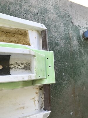

Oh, it gets stupid bro. I’m thinking about abandoning this idea now that I’m $100 in stainless steel. Honestly my last ski had a -2”otherwise stock hull, drilled waterbox and was super badass. Best noise in the whole world. Gurgle, gurgle, BRAAAAP!

I’ve been out of the game for 5+ years and am now old but please don’t use that TDR. They are so obnoxiously loud. I had one and didn’t notice a performance difference between it, a drilled water box, and a sea doo box
Well, Maybe I should have tried a seadoo box.. TDR waterbox is super loud even though it’s the baffled one. I wear earplugs and stay away from people…the good part is it weighs like 4#, about half as much as the stock waterbox. Between that and a lipo battery I’d say I’m 15# lighter in the nose. Not sure if it makes more power but it’s louder so it feels faster. I moved my exhaust outlet back so I can keep it underwater and noise down - and higher so it’s not blowing out my sponson in a hard left turn
