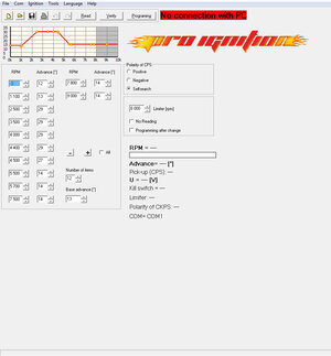

"Igni SJ Pro SuperJet is a high power fully progmable ignition with any computer at home or at water
Now also available for Yamaha SuperJet the Igni Pro full programable ignition with same funciton as our well known SX-R Igni Pro
Comes with software for easy program with any computer and laptop, fully adjustable ignition curve and rev limiter
A must have for any modification - plug in original Yamaha electric box and feel the power differnce

"with any computer and laptop" The program does not work on my Imac.

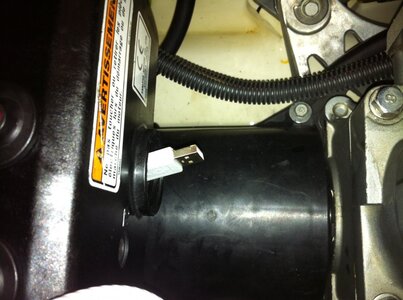

Installation was very simple, basically color on color and then bolt it in.

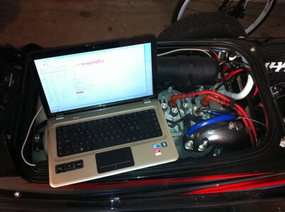

But one thing I found during the installation was that I did not want to open the electronics box every time I want to reprogram the unit. What I did was to cut off the pipe in the front cover of the electronic box so that you can fish out the USB cable through the opening in the box every time you want to program! Worked like a charm!
Now for the programming of the device.
My unit came with a pre-programmed curve as the seller claimed to be equal to an MSD enhancers curve. So I went out to the lake and tested the ski and it started right away and I ran it all day without problems.
But I wanted more so Waxhead here at X helped me with a more aggressive curve, Thanks! And that's when it started happening stuff! The first thing I noticed was that the engine had started to go lean and I had to rejet the carburetors. After the rejet I felt definitely that I had more low end hit.
