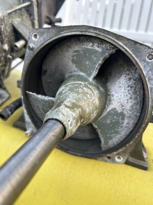

I've seen them worse and still not cavitate. That impeller IS pretty beat though, and I can see the cavitation burn on each blade near the hub. Could be sucking air around the pump housing seal.
