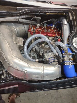

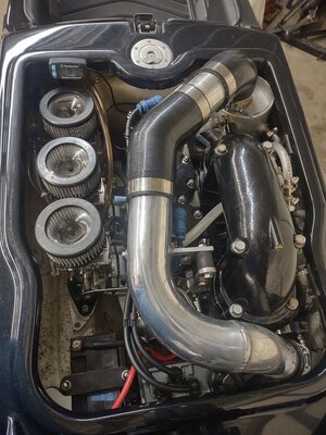

I have a Hydrospace with a 951 and my friend has one with the 1100 triple. I personally feel the handling of the 951 powered hydrospace is way better than the 1100 powered version. Also my 951 without a water box is much more bearable than the 1100 without a watebox. There's no room for a waterbox on the 1100 unless you go centerbleed and over the top and into a custom waterbox like I did with my Bullett Racing Hydro with the 1100 . Example of the "over the top" exhaust routing on my Bullett Racing 1100 Hydrospace.
951 was on my list. More accessible, but electronics are a pain. How did you deal with the the oil injection system?

A 951 is a tight squeeze.

super cool!

Good God there is a lot going on in there !
