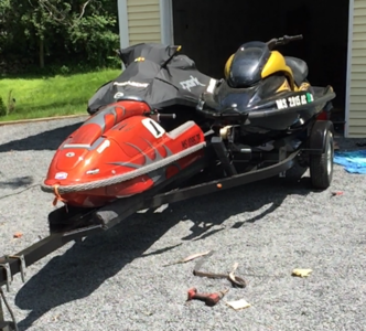

Noticed that a large patch of the hull on one of the chines is missing. It's about 3" wide and 12" long. It looks like raw fiberglass underneath. Of course I'd notice right at the start of the season. There's also a crack near the intake grate. No noticeable leaks and my bilge hasn't kicked on at all.
What's the protocol here? I normally ride the high horsepower couches, and I know delamination at 80 doesn't end well.

A little hard to see in the pictures. It looks like the gel coat is pealing off. If so, nothing to worry about.
just touch up with thickened epoxy and smooth it after.you can color the epoxy for a no show repair.
if the crack you're referring to is at 4pm of pic then no worries.just a bond line of pump shoe .
