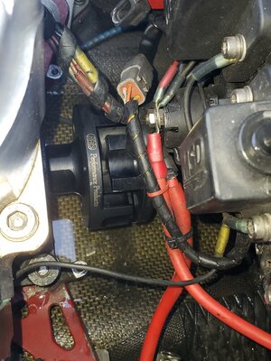

Remove the 4 bolts that go into the motor mounts and slide your motor forward. Pay attention to any shims at each corner, save them, and reuse accordingly.
In order to do that you'll probably need to remove the fuel tank, take off the exhaust chamber or any other interference.
