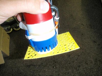

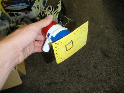

here's my quick and dirty solution for when the current bilge falls off
its a piece of plastic that will spread the gap between the two humps in the rear of the hull. I'll just put a thick bead of 5200 on the top of each hump and place this on top
the holes are for the 5200 to adhere better
