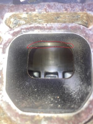

So I'm using some yamanube porting templates. In the pic we are looking in the exhaust port and see the sleeve overhang [62T 701 cylinder from a raider] I know the red circled part is the port height and can't be touched unless I want a higher powerband. My question is, what about the rest of the sleeve overhang, can that be blended, shouldn't be touched, or doesn't matter really?
