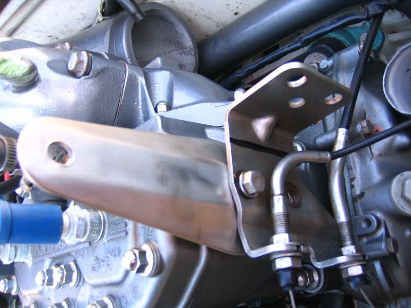

Got a Factory limited pipe for my 95 sxi.
My question is, the bracket on the front of the front cyllinder that hold the throttle and choke cables seems to be in the way of the chamber. I could be wrong though because I just did a mockup without the 4" and 2" silicone couplers.
Anyone got any pics of this area??
Alaska
Basically I just need to know if the FP bracket is used with the stock bracket?
Alaska
I must have an earlier version. Looks like Im gonna be fabbin again.
I could cut the "L" of the stock bracket so it leaves just the cable bracket part,
and sandwich it in between........maybe.
Screw it I'm tigging.

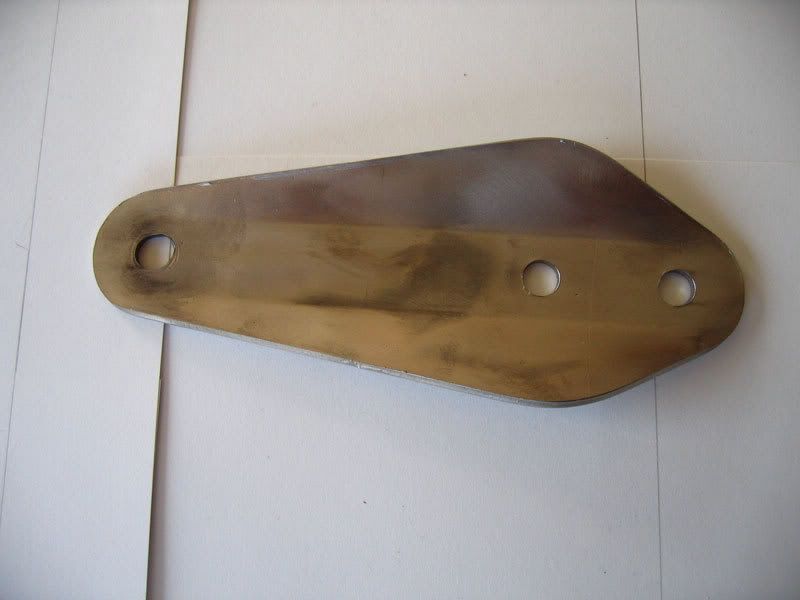

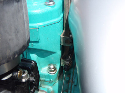

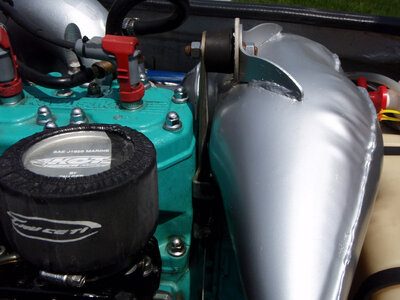

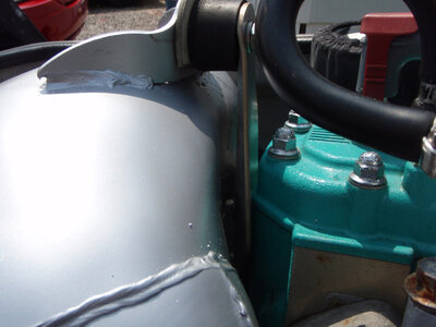

Waternut
Customizing addict
Macon, GA
I guess the older SX brackets were different. Here is what mine used to look like. There is a spot for the choke cable as well behind the throttle cable.
