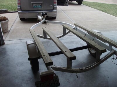

spacing is almost exactly 12" on center.
some folks just run them skinny side up, I prefer to angle them about 30 degrees to match the hull.
I think ive got some pics in my gallery, Ill try and find them and link them.
welcome to the X by the way!
WELL edit.
I cant find the OLD gallery, someone hook me up?

Excellent gallery, wow that's pretty much exactly what I was looking for.
So yeah, height off the deck is the only real thing that I'm unsure of, though it looks like you've got them mounted directly on the cross-members. (So no height is needed). Do you expect the '08's different hull (I think there's a new hull...) would affect the spacing or angle?
And what about securing it at the bow? I see you made some nice little brackets that fit through a hole in your bow... Do all skis have that nice mounting hole? If not, how would you recommend securing it to the front of the trailer?

all the yamahas I have fit this trailer, superjets, VXR, and FX1 have that Bow eye in the front, drop the pin thru and ready to roll.
If its really a bumpy road, I strap across the trays of the skis too, but its not needed on typical paved roads generally.
Oh yeah, my kawasaki 750sx fit on this trailer too.

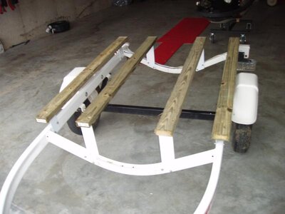

Mark44
Katie's Boss
100% one place
u
Single turned into double then I just installed carpet on them.
