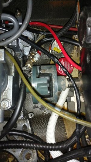

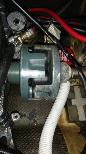

Hey guys, everywhere I've looked the answer I got was to have the couplers 2-3mm apart
As you can see in this picture mine is way off but that is how it's been
Everything is aligned correctly(checked before I pulled motor to do motor mounts)
It's a 96 rn with a raider 701 in it, is the coupler on the raiders closer to the motor?
If I slide the motor back to 2.5mm the bolt holes for the mounts won't line up
