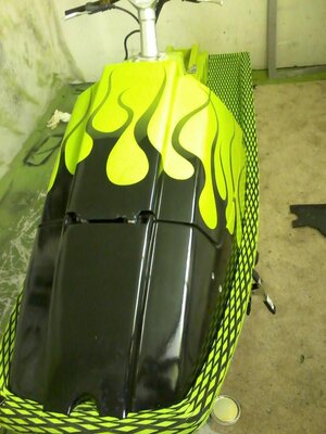

I just put back together my motor, and it ran good for the first hour and no cavitation, The next time out it started cavitating on me. It does it almost all of the time at both high and low rpms, I did get it to go again for a little bit, I tried to silicon the pump better, no luck. My motor is pritty built, 650 with keihnin 44 carb, head exhaust pipe, box flyweel ect. I just cut 3" off the back and moved steering back 5" and added a trim lever, now I can't ride, I have a stock skat track prop, could that be my problem, The clearance is tight. Could it be something in my fuel system? I was reading another thread, and they said it could have some thing to do with my fuel. Could it be my mixture? Or the H and L screws not adjusted right? The motor sounds good and revs good, but just doesnt go anywhere?
