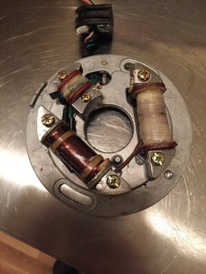

Is anyone able to tell me if this is a 61x or 62t stator? I know there's something with the connections being different but without having them side by side are there any easy ways to tell?

That is a 61X.
I posted a side by side pic of them once and listed the differences. maybe somebody will repost it here.
The two quickest identifiers I look for are;
62T has black plastic surrounds on the charge and lighting coils.
62T has an extra crossbar across one of the holes in the backing plate.
