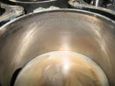

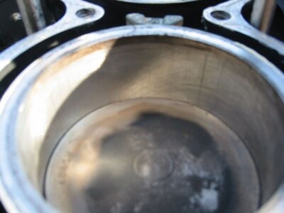

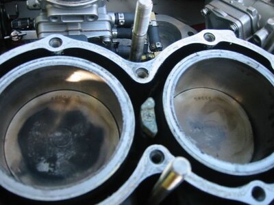

paul read this from atlanta and pmed me with his personal cell number so he could help me out (awesome guy) he said to pull the head and see if there was deto or anything in the back cylinder because of the leak. he's off to dinner now so i don't want to bother him. here's the pics i took, are those vertical 'lines' in the sleeves normal? they appear to be the same in each cylinder, so i don't know if that's normal or not.....

those vertical lines look sort of like water ingestion marks?
I would hold off and let Paul give it a clean bill of health.
too much of an investment to rush and do some damage in my opinion.

You'll see deto marks on the top of your pistons, they show up as tiny holes (because the material actually melts away in the case of detonation). Those piston tops look pretty good to me, granded it's not a big clear picture so that that with a grain of slat. Check the compression when it's cold. Always start off rich when you're figurin' out carbs!

maybe the headgasket was breached, and letting one cylinder loose a little?
could also explain the water marks.

Yea the pistons are still in great shape, and the cylinder walls still have the criss-cross pattern when i run my fingernail over them, so i think everything's good. the orings between the domes and the sleeves were a little melted though. Paul says he thinks the leak in the carb leaned out the mixture, causing the cylinder to overheat, since there's no carbon residue on the back piston. since the mixture was so lean he said there's probably not the right amount of oil in the cylinder, which maybe explains the compression change. i'm gonna pop the head back on and fix the carb gasket tomorrow, then i'll try it again. thanks for the help!
alright i found the problem today. it looks like the carb gasket that covers the jets/needle/seat assembly in the back carb is bad. it wasn't pressing itself down enough, and there was fuel on the outside of the gasket. i replaced it with one from my 38's and everything appears to be in order. compression is actually better than before, as it is 180 in each hole. my buddies are coming later and we're gonna ride so hopefully i'll be able to get everything dialed in! thanks to everyone (especially paul) for your help!
if you look closely at the pictures, you'll see that the back piston has virtually no carbon build-up on it. paul said that it probably wasn't getting any fuel so the cylinder basically had no oil in it causing it to have low compression and to overheat and melt the orings, which also may have contributed to low compression.
