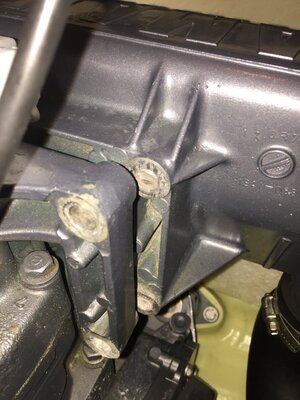

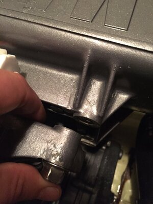

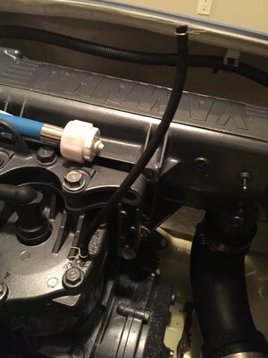

I discovered that I had broken all three bolts that attach my exhaust to the cylinder head. I wasn't jumping hard at all and I have no idea how these all completely sheared off. Needless to say I noticed reduced power as I was just putting my ski on the trailer. As you can tell from the pictures the smaller cooling line popped off. I'm concerned that I may have damaged the ski? A quick compression check revealed equal 160/160 compression.
My questions are:
1. Do you think damage occured?
2. How would you suggest handling the situation: A) Attempt to remove sheared bolts through tap/die B) Buy a new exhaust?
3. What is the easiest manner to remove the exhaust? At what point would you take it off to minimize parts removed/gaskets removed etc..?
Thank you in advance.
Adam
