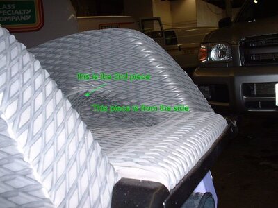

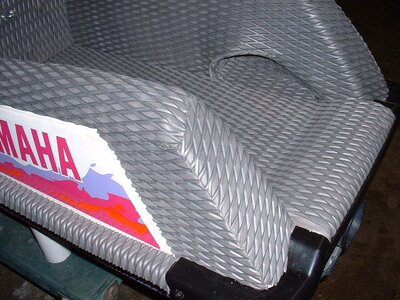

you can always cut out "feet" in the turf and replace just the footprint in the foothold with perpendicular diamonds. ive phukt myself up because of the diamonds going the wrong way.
with the turf dry, try sliding your hand or foot in one direction, back and forth, on the diamonds and then at a perpendicular angle back and forth. its a lot more slippery than you might think.... especially when wet.
