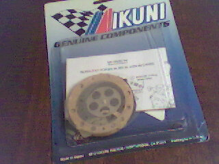

Mikuni carb kit

I have the kit brand new $20 shipped mikuni brand.
