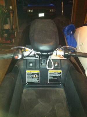

I'm working on doing the hand warmer mod to my ski right now. My question is how did you guys run the line from the hand pole into the engine bay. The rubber boot for all my lines has very specific holes and all of them are filled. Here is a pic. It doesn't look like there is any room. Did you pull out one Of the green lines? If so which one.

Chuck out one of the green tubes the one is for the tank the other a battery breather which if you got a gel battery you dont need anymore
