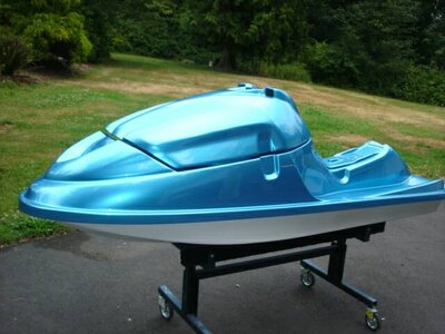

The outside pic it what it looked like when George sent it to the original buyer.
You can see the rotisserie I built- almost done with it. just need to add wheels and attachment points.
