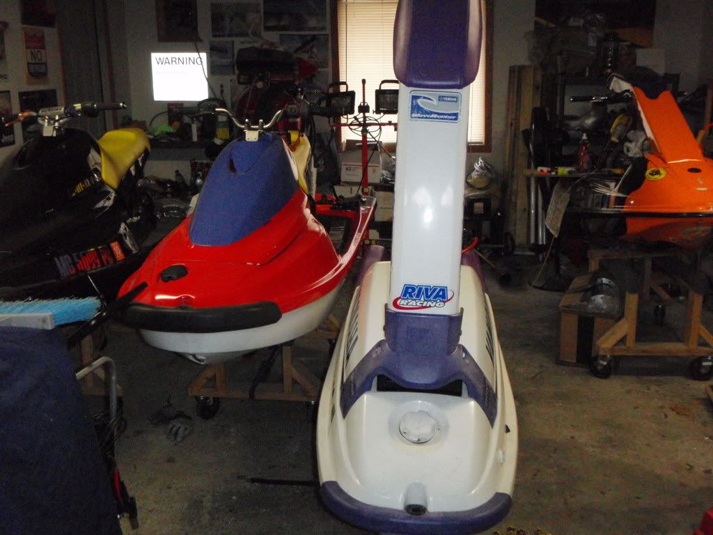

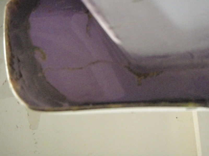

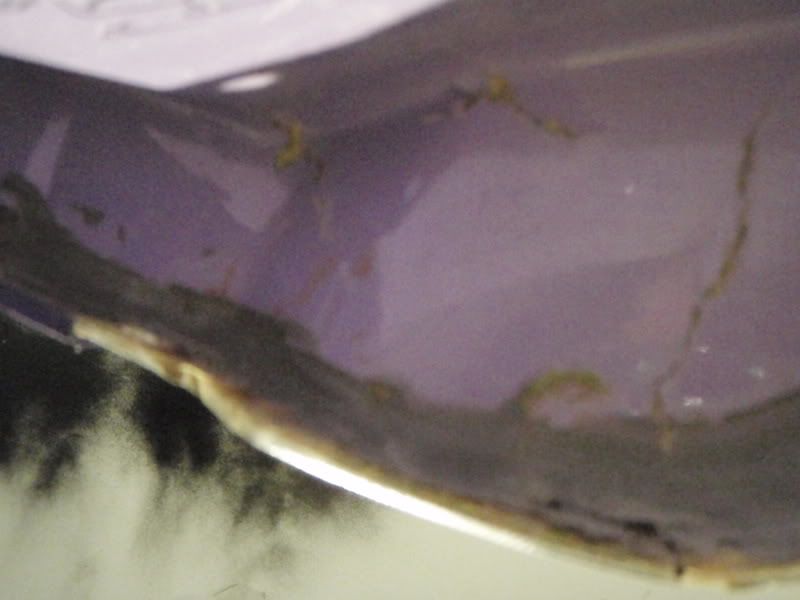

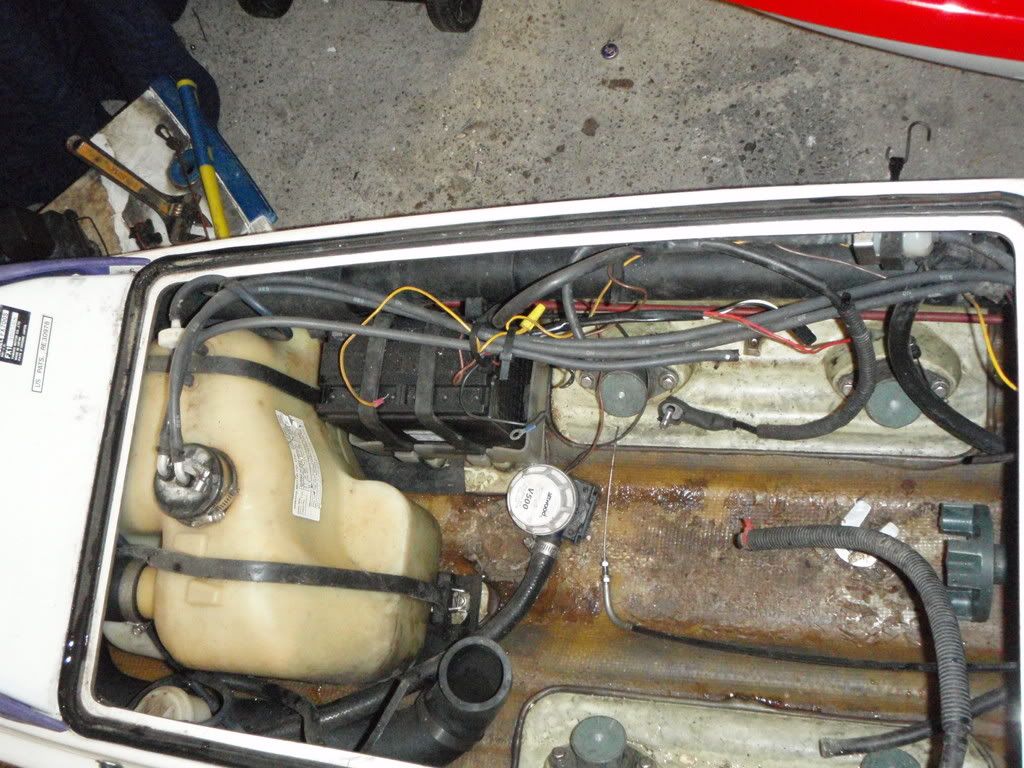

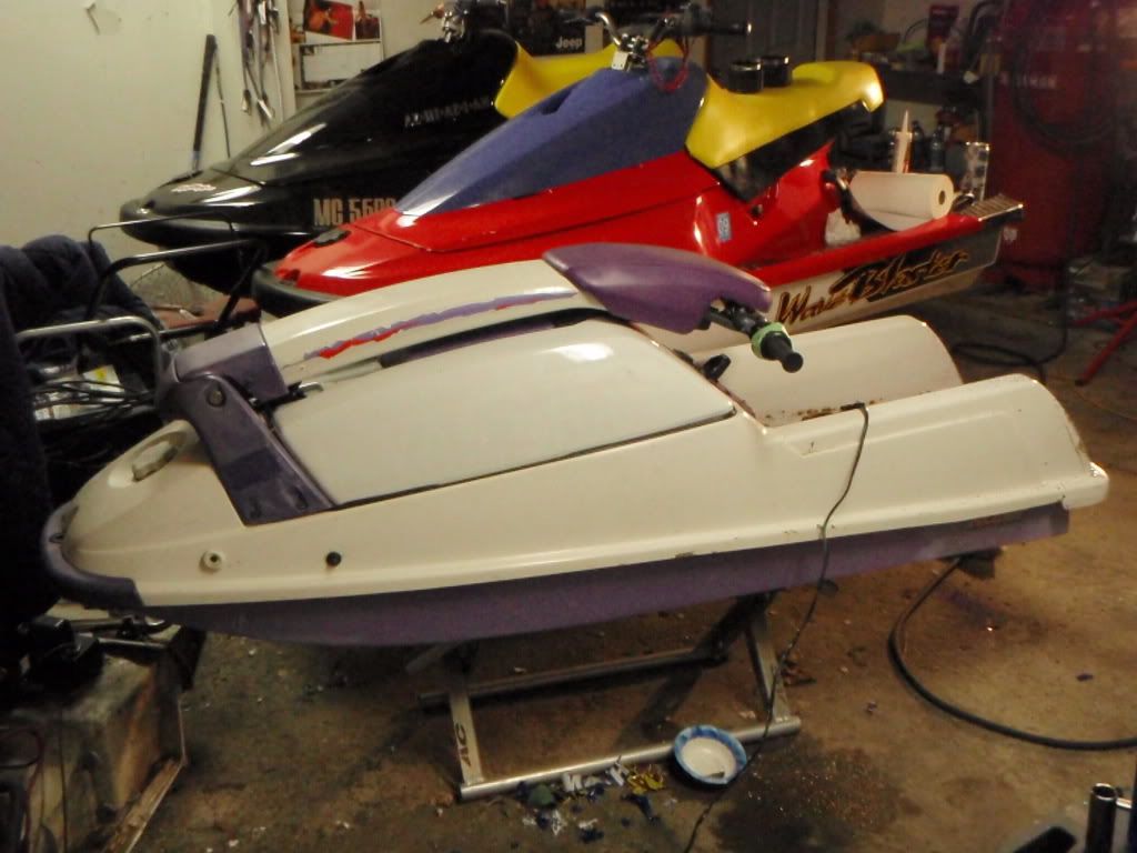

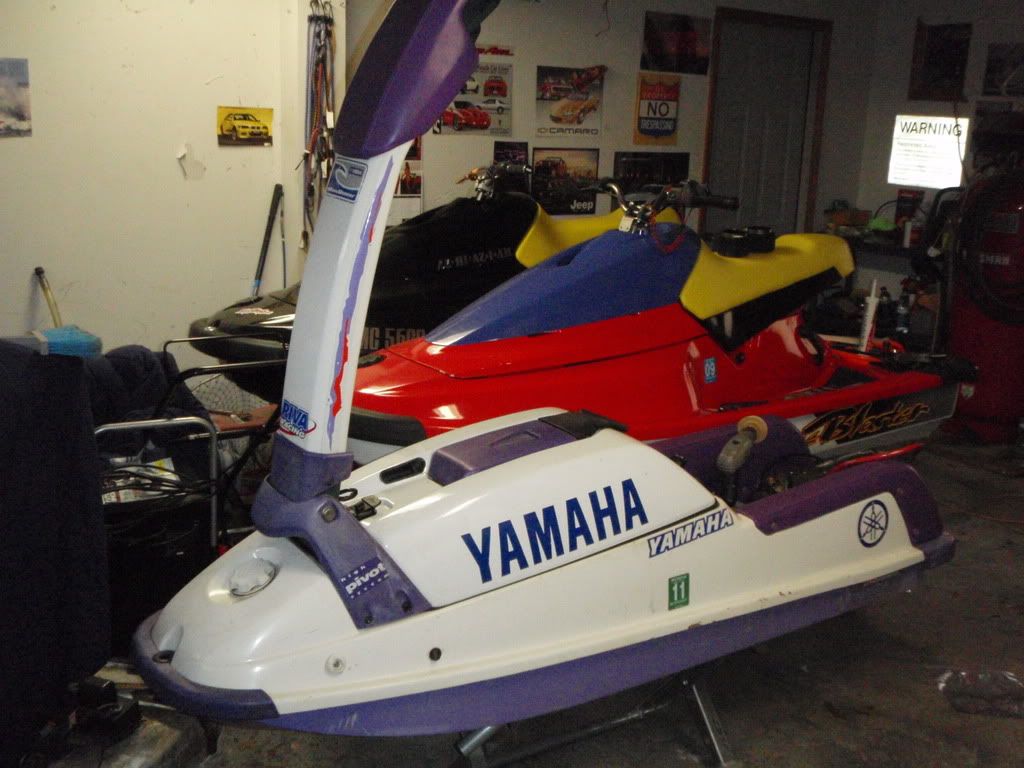

Well, went out and picked up an fx-1. This will be the girlfriends ski she is not to fond of the blaster,she would rather ride a stand up. This will also be my back up ski as i am in the process of building a square also. I am new to the fx-1 so any and all help would be great. Here are a few picks when i brought it home

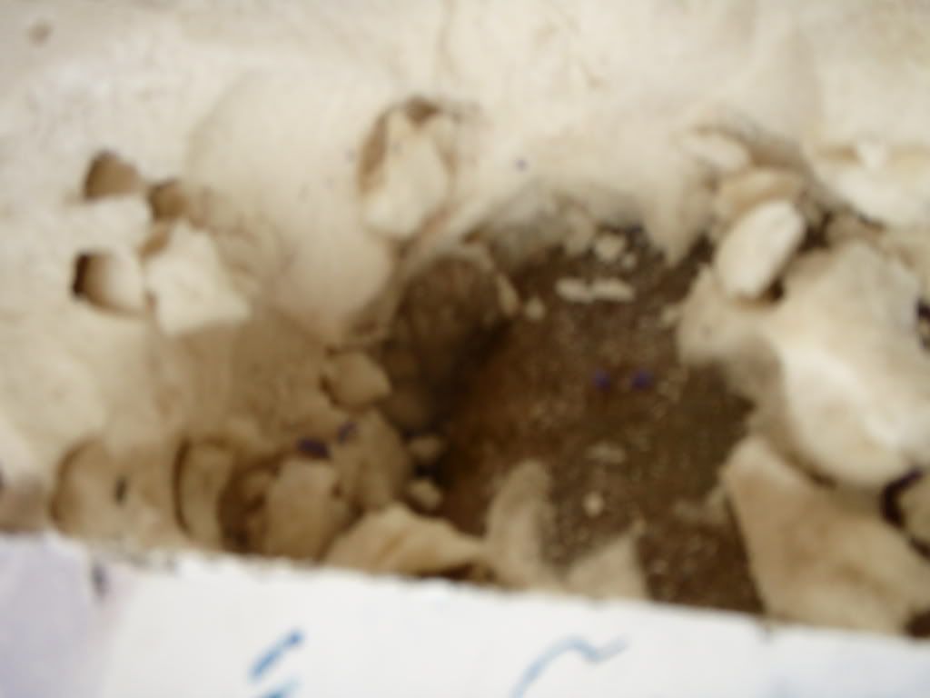

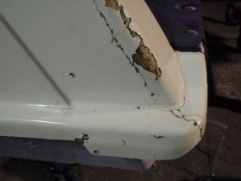

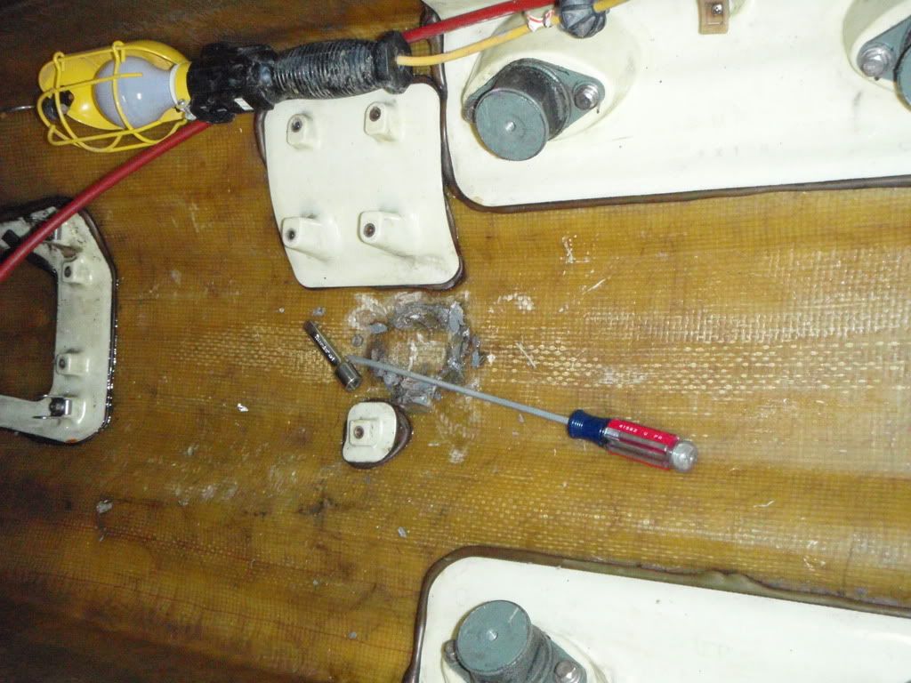

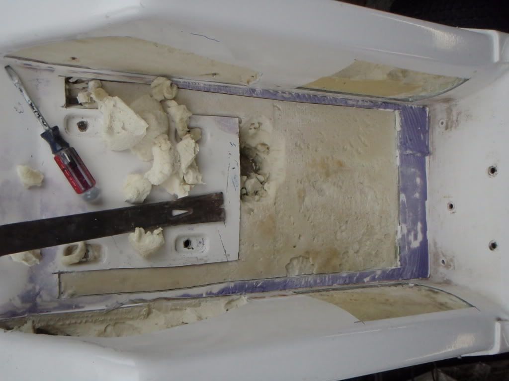

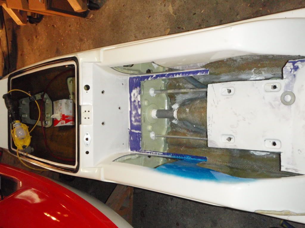

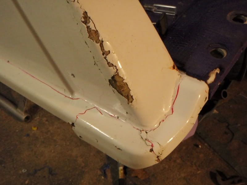

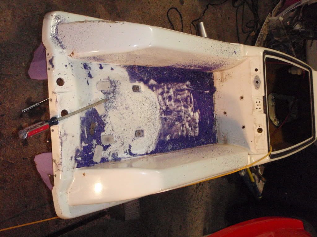

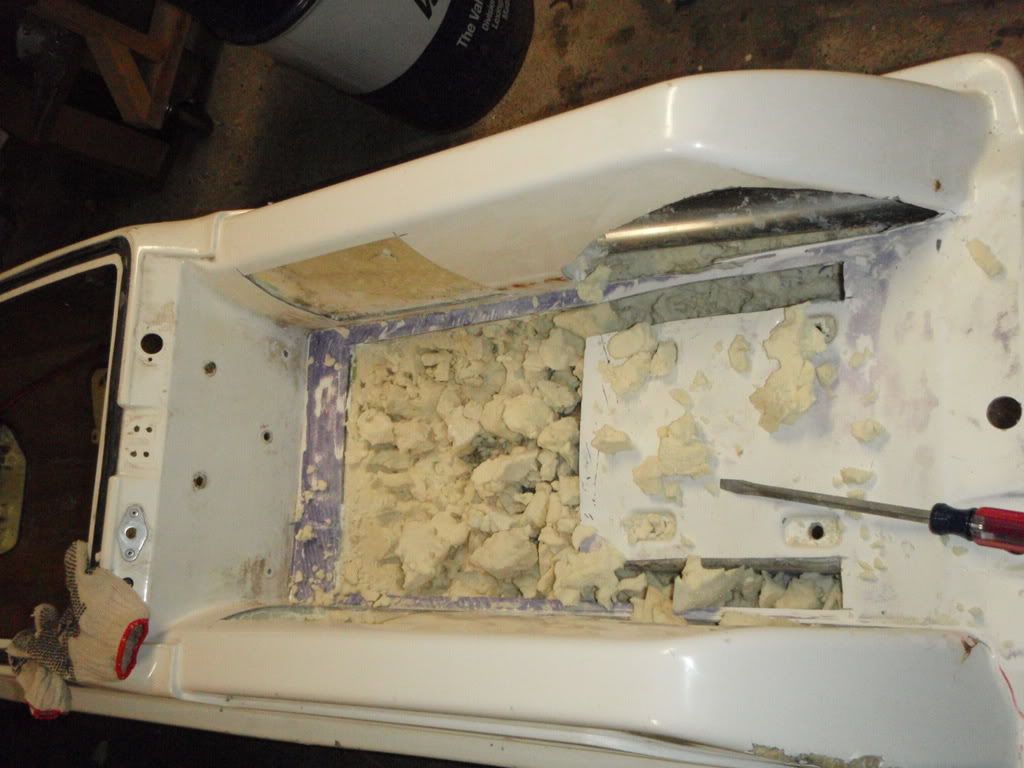

After a few hours i was tearing into the hull. I am defoaming to fix the hull damage. I will be installing watercraft footholds and i have a set of his sponsons here also,i just don't know if there wide enough. The foam was soaked so this is where i am now.
Lookin good. You consider putting in a bigger pump while you already have the tray defoamed?
Next thing you know you'll be taking the fx1 and giving the Sn to the gf.

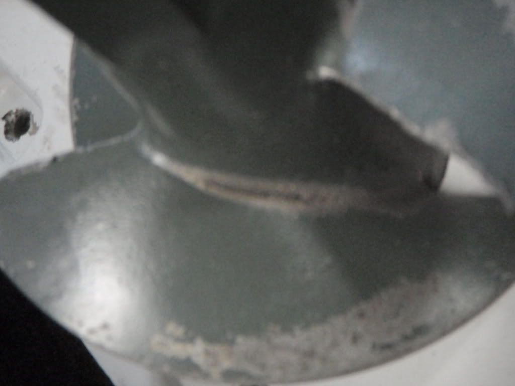

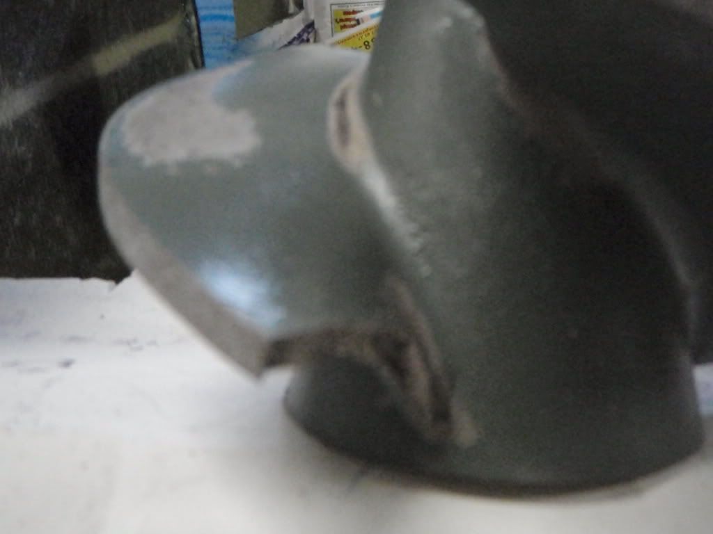

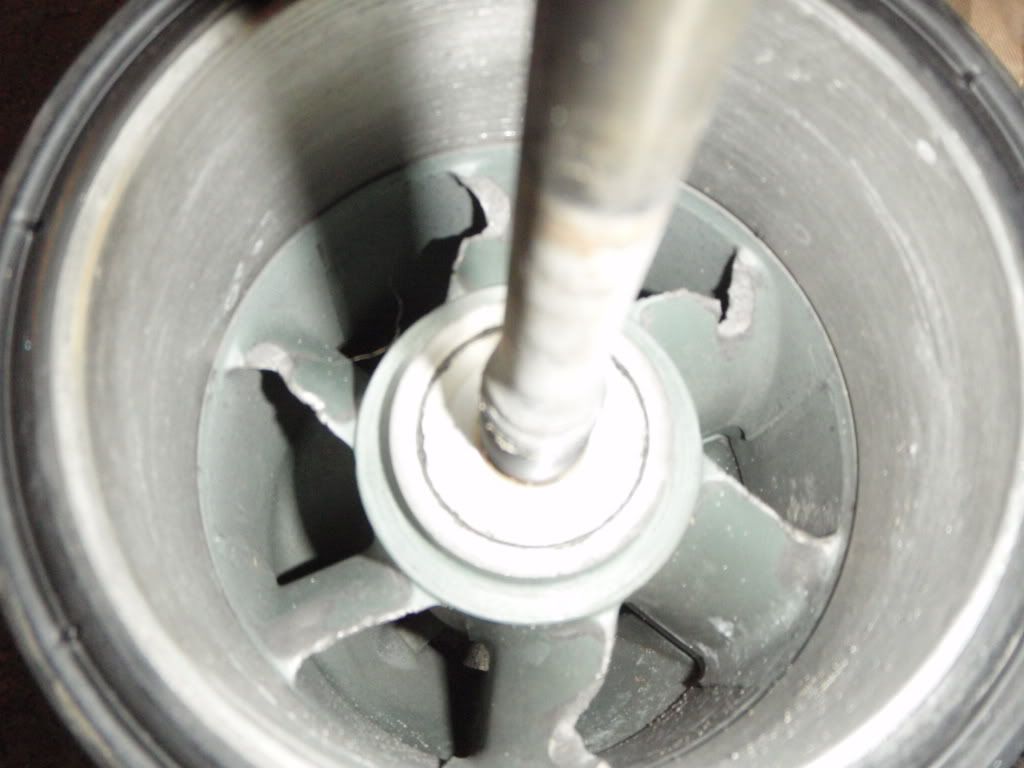

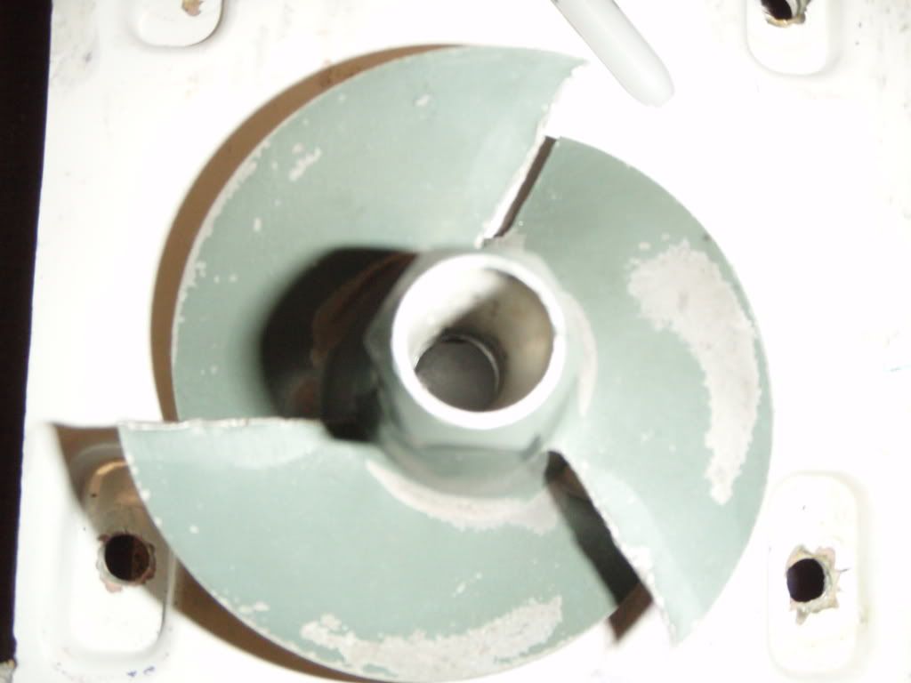

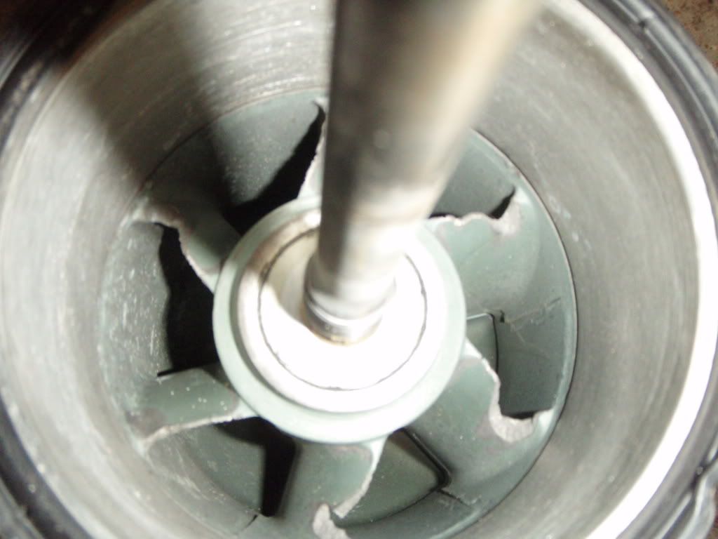

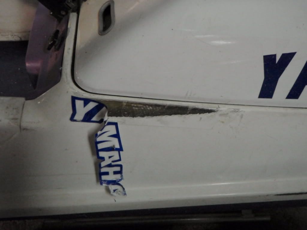

Man has this ski been ridden HARD! The hull was pretty beat up as you can tell,the crank was bad,mid shaft is shot. Today i take the prop off and O MY WORD! The impeller was coming apart as they wer riding. The pump vanes are some of the best i have ever seen!
