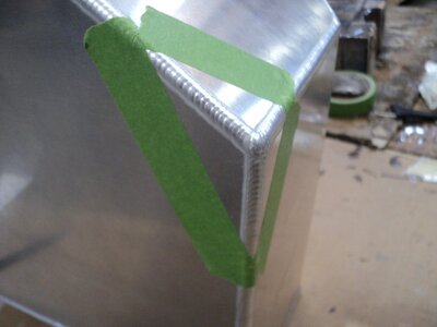

Type LimitedSlip7 in search box for members, guy does primo work. If your ever in S Jersey hit me up, show you what I did. If you go with this tank ask him to do this:
Really helps with this:

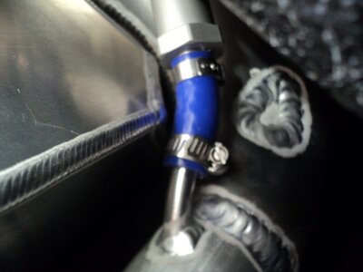

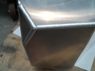

Yes it is, with battery tray. I don't know what you did with your batt, but my buddy cut up his tank and eliminated it and gets way over 5 gals. in his now. Bot is pretty tight on space though, not a lot of alternatives for batt location. Probably could of made tank work without corner mod, but it was brand new and now was the time to do it. Didn't want that stinger pisser kissin that corner.
Yea that looks like a must who did the mod?
The Man himself, LimitedSlip7. Pm'ed him, taped out what I wanted, he took it from there. Great guy to deal with, wouldn't hesitate to use tank again. If you buy new have him lob that corner off, save back and forth shipping. Don't know what PFP you got but mine was one of the new 3 oring ones and my buddy thought that stinger pipe connection seemed lower than b4. If yours is higher (12 o'clock as compared to 10 o'clock like mine) you probably would b ok without mod. Extra space is always nice though.
