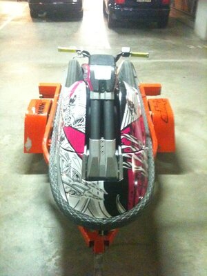

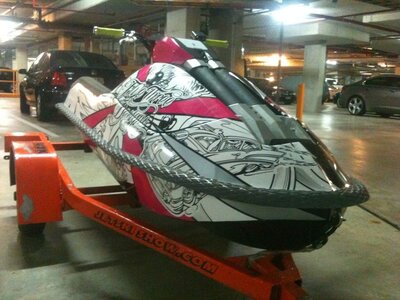

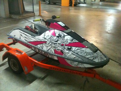

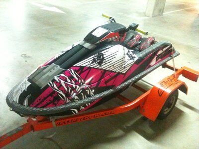

I just had the ski wrapped by Joel at Five Three Designs on the Gold Coast in Australia. Joel and FTD are well known in the MX industry over here for the sickest Bike graphics in the land.
Anyone who says these things are bad in the surf/for surf riding just hasnt spent enough time on one.
Sorry about the iPhone pics and the ugly orange trailer.
