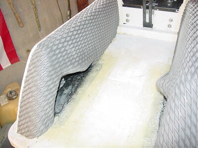

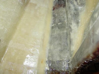

wall
filled the joint with 404 and ran fiberglass up the wall and across the haul. Just want to get my boat ready to ride for the summer. Add a little strength.

I think I see random mat in one place, tooling mat in another, mabye its the pic, but it just looks all over the place. Did you read any build threads before starting? Your supposed to get rid off all the white (down to the metton) before glassing. Not a huge deal but.

thanks for all the help......hull.....I did get rid of the the white after I was instructed too...Just a small area of white left.
I guess you are all right, should have done it right the first time. Learn from my mistakes....
Wasn't going to do any glass work but felt like I should something the help the HULL.
Like the title says "First time"
Looking for any positive or negative comments

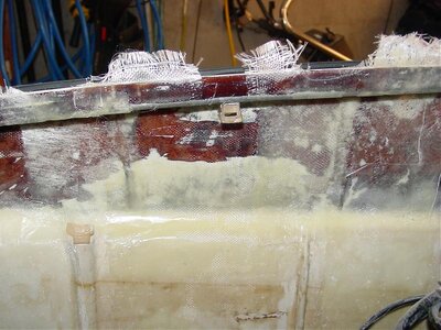

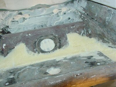

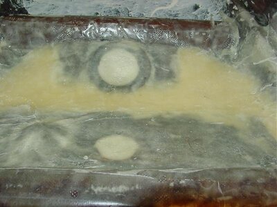

Glassing nose
ground the ribs down and foamed in the holes. What a mess! I had fiber glass and foam everywhere! I will post picks of the fiberglass once its dry!

Well if its your first time with glass, I'll give you that, but I really cant make out what you did. It honestly looks like its piece-mealed together from random scraps of glass. Next time, you want to make it as neat as possible, if you have random scraps, you'll have strong points and weak points, it will crack where you have changes in strength. You want ideally two or three tapered layers across the sides, each going full length, the smaller layers only vary in height, and go on the bottom (so if that bond fails its not the entire laminate), and the bigger layers go on top. You want the glass to overlap neatly so that the impacts are smoothly transferred across that.
Get a few books on fiberglass, or find a good composites forum, as its very tough to describe the perfect way as depicted in what I've read in just a paragraph or two.

when laying glass its best to use the biggest pieces of fiberglass you can. bunches of little pieces won't do you much good.
you coulda left whole ski alone. reinforcing is really only necessary when your going inverted. and even then lots of people havn't reinforced.
keep looking through the buildup pages and look at what other people have done then you will get a good idea of what has to be done and ways to do it.
it just takes time you will get the swing of it.

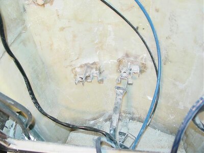

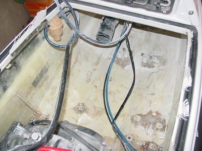

Nose Reinforcement
Three layers of glass in a U-shaped fashion in the nose! Feel much better about nose area! Ready to start assembling things now!

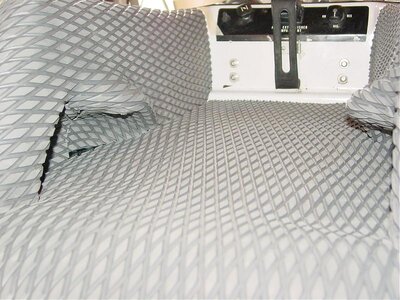

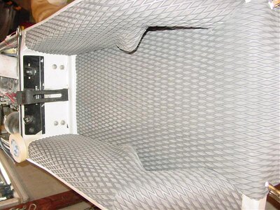

Hydroturf
finished the hydroturf tonight. Planning on installing the ADA head and B-pipe tomorrow. Any pointer??? Looking forward to some summer weather!
