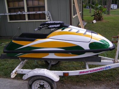

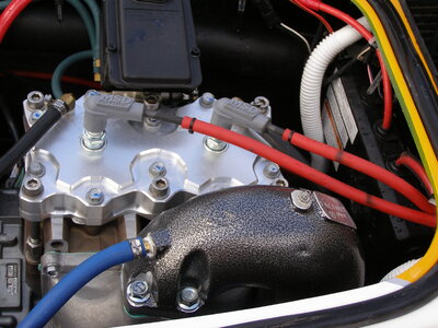

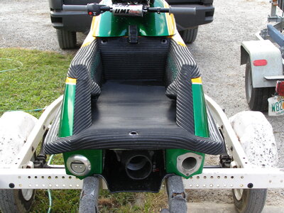

one october build finished and out the door . light weight hull wammer ,hood,nose . 780cc flattop ,novi48/44 ,rrp pole and bracket msd enhancer , solas 13/17 stock pump open 87mm rrp quick turn , ht and house of kolor paint lamborgini yellow and money green and green pearl white .

Awesome boat !!!
Here come the questions:
Is this a Wammer lightweight hull?
What does it weigh out at complete?
Who ported the cyl. and how does it hit w. single carb and that pump set up?
Is this yours or did you build for someone?
Nosey MF's wonna know.

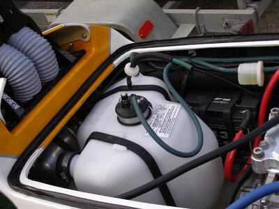

the gas in the filter is mixed and is maxima 927 which is almost clear yellow basically the same as the gas which sux but it is great oil . yes its a wammer hull the engine is great and very reliable running 200psi on pump gas 93 for years never had any problems with the set up . total weight i will get to you later as this one just got shipped out to the customer so the answer to your other ? is yes i built it for someone else .:Banane01:
That is awsome news for me! I was told before that my motor will be a ticking time bomb.....doesnt sound that way to me!:Banane01: My compression should be right at 200psi, but I thought for sure I would need to run at least 50/50 race/pump gas? Should be a nice change from a none ported stock bore motor.

yea it should be no problemn as long as you are not running it for race like situations free ride ans=d freestyle is good . for five plus years ive had probably 50 of these motors out there and never seen one blow some lost compression over the years and got a new top end but that is it .

wammer before he changed it for this year . yea the maxima is like honey thick but coats very good . of course it depends on how you ride but i think rick can ride pretty hard so i think that would be ebough justification .
