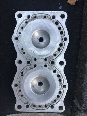

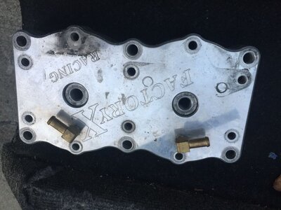

Got this head and girdle bolts in a box of parts that I purchased. Does anyone have any experience with it? Was there a special head gasket or did it just use a stock gasket? The only O-ring is around the water jacket outside. Please share some info :)

Gonna say this is the same as the Greater Yamaha, Wamiltons heads, Think UMI made them, There have been a few others that were made with their on label on them.
Yes you need a head gasket because you need to seal on Yamaha sleeves. Most Yamaha dome heads the domes sit down a couple thou to hold compression on the press in sleev
Run a head gasket or you will be sorry.

Thanks guys, I figured that ( see my 1st post). I was wondering if it originally came with an aftermarket head gasket or if it was designed to use the stocker?
I've got a bunch of those since a local sacramento guy steve sabotnick was factory X racing. mike coe ran a lot of his stuff and he was a real guru. he made pipes too using a Coffman sizzler head pipe with a water adj mod like factory pipe and welded up his own chamber. most of the superjet stuff I got was early to mid 90s square and RN stuff, so yea, its very old school when the SJs first came out. that head is going to be very high compression and I would just run the thick stock head gasket to lower it some. its race stuff for sure and it probably used 3 base gaskets to raise port timing too. that head does not make sense with a waterjacket seal but no chamber seals. I've got some with dome Orings and 1211 for water jacket seal. I know they used to top deck the cylinders and maybe with 2 perfectly machined surfaces, they didn't need a head gasket. at least for 1 race anyway
