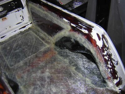

i used 5 minute epoxy with silica and duct tape to hold the corners waited for epoxy to dry. removed tape then silica and us composites fast set epoxy waited for it to dry and glassed in the pieces with 17 oz. thanks to crammit for all the tips and getting my parts list ready . mine is solid as a rock . i dropped my ski off the stand today and :bigeyes: it bounced. im glad i reinforced the back while i had it opened.
