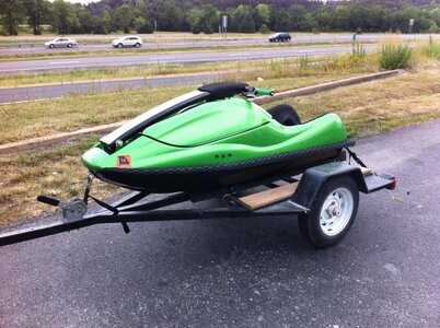

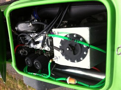

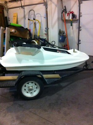

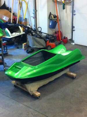

After a few months of riding this I figured it was time to make a build thread. So here she is.
2012 QSM VENGANCE hull
835cc bigbore
TW porting
44mm blackjacks
144 Scat mag setback pump
X-metal pole
Advent ignition
Wet pipe
I went with 2010 camaro synergy green on the top deck and a black bottom deck.
Larry was super cool and easy to work with on the hull, straight forward and always answered any questions I had about doing this build. It was pretty much a straight forward swap from my sxr to this ski.

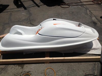

No that is not even close to the rok-r... That is just a sxr shortened with rocker. The rok-r is its own animal. It just shares sxr like body lines
That's why I said "looks". Most of us that have been in California have seen this hull in ads and on Craigslist. Also the QSM hull does have its own identity other than just being a shortened SXR hull.
What's different?
I don't know the specifics since I was not involved in the development. Maybe Mark could chime in here on the changes or maybe the op could tell us more about it. Obviously the pole location to start. Copied from youtube vid "Mark Gomez testing barrel rolls on the new VENGANCE light weight freestyle hull built by QuickStyle motorsports in Ontario, CA. The hull is Kawasaki based with advanced hull modifications to improve stability for flatwater freestyle.the engine in the ski is a Kawasaki 4mm 880cc stroker motor with total loss and a Magnum pump. Contact Quickstyle Motorsports for more information." To the OP, sorry for the thread jack, really like the hull. Might be my next one since I really like the SXR.
