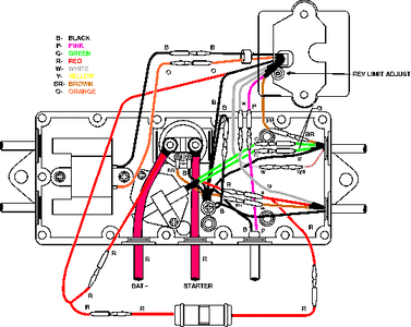

ebox wiring diagram

I was wondering if anyone has a ebox wiring diagram for a 650 superjet with msd enhancer? I'm trying to clean up the inside of the ebox for the motor swap. The owner before me bypassed a bunch of wires.

That's a temperature sensor. You can just hack those wires off - you don't need the sensor, and no after market heads support it in any case.
